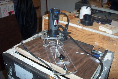

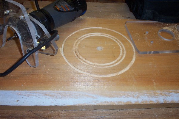

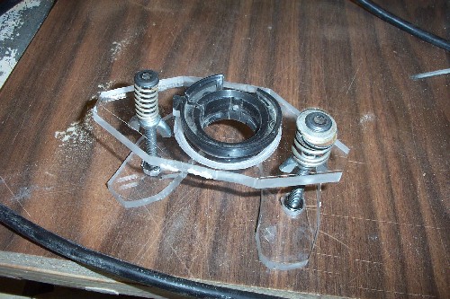

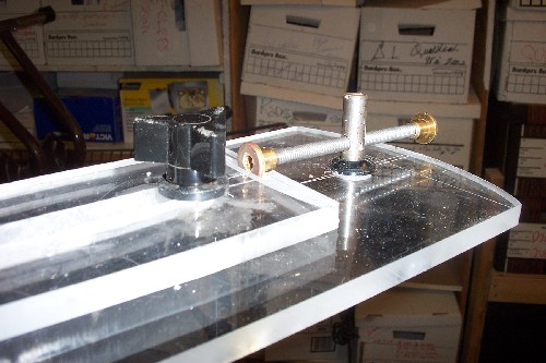

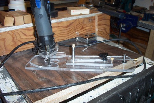

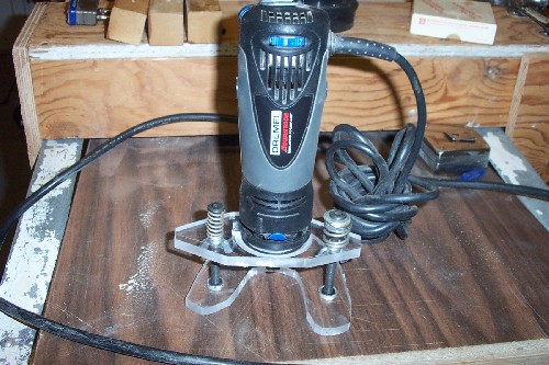

here's a rosette cutter jig i attempted making for the last few days, it's a rosette cutter inspired from the latest threads and hopefully, it's gonna help me with that daunting task!
Here it is
I did a couple test runs with it and it was easy to swivel around but it needs a few adjustments and i'll need to buy some more stuff for my dremel like an adapter for smaller bits. Looks promising so far!
Thanks for lookin'

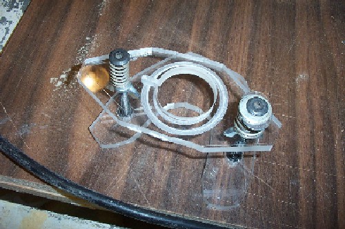

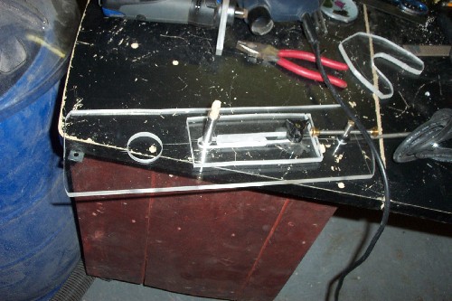

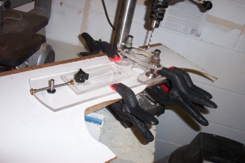

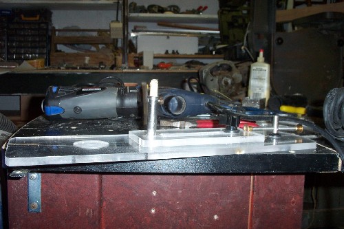

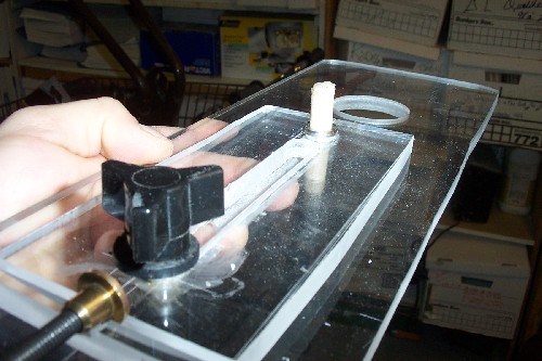

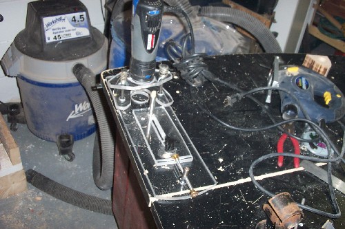

Here are 2 more pics of the jig which still needs refinement and i'll be all set for the week end!
